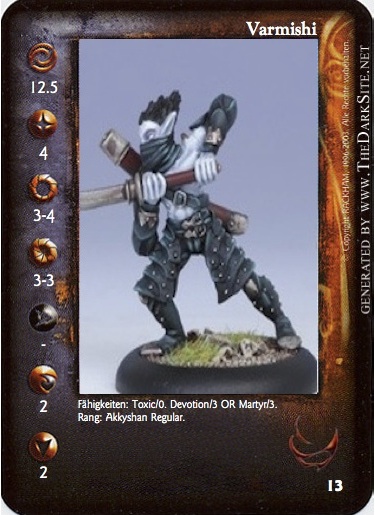

Vârmishi (the name derrivates from „vermin“)
These are the lowest ranks, formed from slaves and young warriors who have not shown their worth yet. They are often sacrificed for cruel rituals or prtecting their superiors with their lifes.
Abilities: Toxic/1. Devotion/3 OR Martyr/3.

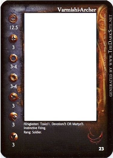

Abilities Archer: Bow/STR 4. 20-40-60. Abilities: Toxic/1. Devotion/3 OR Martyr/3. Instinctive Firing.

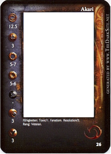

Akari (the name comes from the classification for mites)
If a Vârmishi survives long enough, he becomes an Akari. He has shown his worth and can rely on the Vârmishi to save his life. They still guard their superiors with their life, but they are not sacrified any longer.
Abilities: Toxic/1. Fanatism. Resolution/3.
Abilities Archer: Bow STR/6. 20-40-60. Abilities: Toxic/1. Harassment.

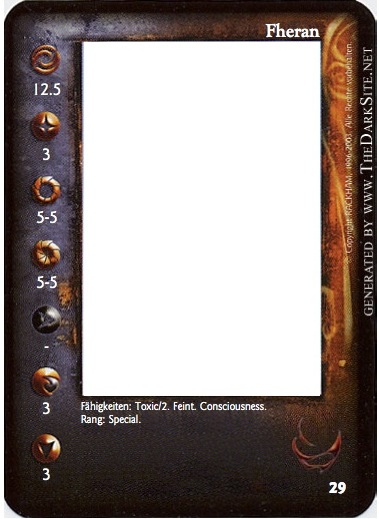

Fherân
(derivated from „feral“)
They mastered the control oft he many beasts in the army of Ashinan. Those beastmasters learned to melt their mind with the minds of the beasts to have a better control. The beasts can be used without the Fherân, but only together they unfold their true potential.
Abilities: Toxic/2. Consciousness. Feint.
Special Ability: When building an army, up to three beasts can be assigned to a Fherân. For 5 AP they can get the ability Consciosness. If the Fherân and a beast are within 20 cm, they can use the eyesight of the other miniature.

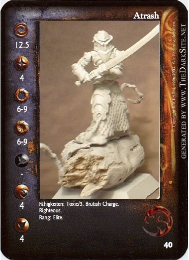

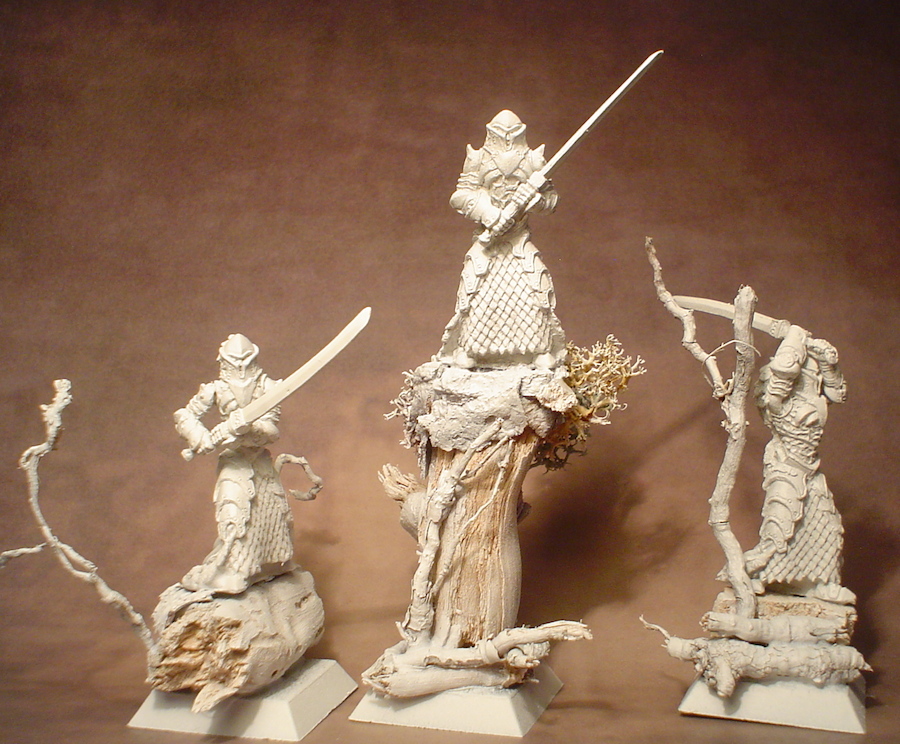

Atrâsh (derivated from Atrax robustus, the very poisonous australian funnel-web spider)
This is the first form of elite. Hardened in many battles there is less that can distress them. Their faith in Lilith and their loyality towards their leaders is solid as a rock. Brutality and Cruelty are valued and the revenge of their masters is made to theirs. They command the lower ranks.
Abilities: Toxic/3. Brutish Charge. Ferocious.
Special Ability: An Atrâsh can command his inferiors 20 cm around him. For every command he has to reduce his MOV for this round for 2,5 cm. When he moved already, he can not use this ability. A Vârmishi or Akari can move again his MOV on the card. With this movement he can attack (not charge) an enemy. If he has to resolve from hand-to-hand combat, he gets Resolve/7 for this.

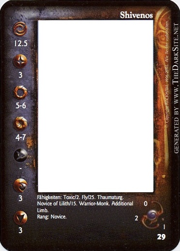

Shîvenos (from Selenops, again an australian spider that is able to glide)
Those priestresses are favoured by their godess, as one can tell by the deformations of their bodies. To have a better overview of the battle, they developed wings like some spiders and direct the battle from above.
Abilities: Toxic/2. Fly/25. Thaumaturgy. Novice of Lilith/15. Warrior-Monk.
                                Additional Limb.
Special Ability: They can use the ability Martyr even when flying.

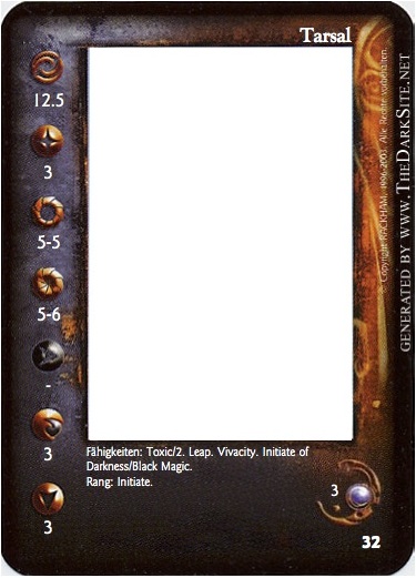

Tarsâl (from the Tarsal claw on a tarantulas leg)
The fighting sorceresses from the Sisterhood oft he Widow command the battle regarding the orders from the Matriarchs. They have no scruple to kill the inferiors or sacrifice them for their own needs.
Abilites: Toxic/2. Leap. Vivacity. Warrior-Mage. Initiate of Darkness/ Black Magic.

• The AP for Vârmishi and Akari is 2-3 point stoo high.
• The Atrâsh and his abilities are quite powerful. Three attack dice with almost a sure hit (Ferocious and ATT 6) with a Toxic dice is much for 45 AP. Maybe the cost should be higher, or he gets another ability than Ferocious. Or maybe if he uses his special ability and gives orders, he can't charge in this round and thus lose the extra attack dice.
• The Shîvenos has to pay +1 TF per level of altitude when casting a miracle while flying. unfortunately, I could not include the Flying movement into the MOV part, but that's the fault of the Card Generator. But the physical stats are too high for a flying unit at that cost.

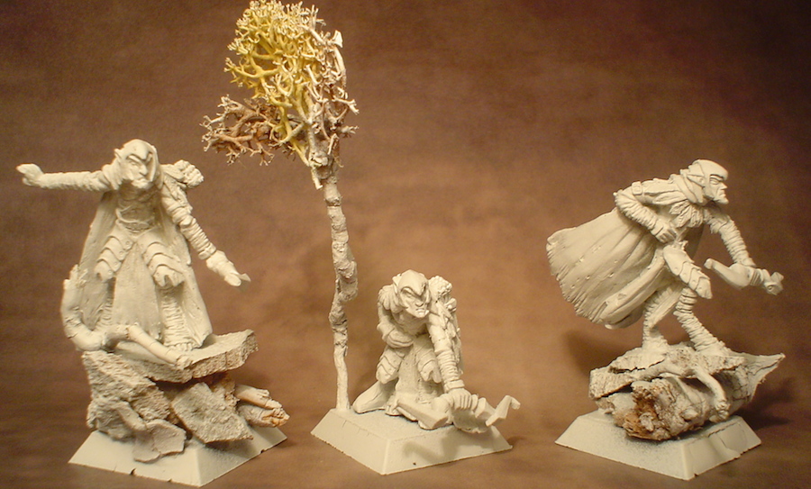

But now, I want to show you the miniatures I selected as Akkyshans and, of course, the originals.
Many of them are from Hordes, the Legion of Everblight. First, they have pointed ears and are looking like sinister elves. Second, mostly all the characters are female, which fits perfect to the Akkyshan. Further, I have two perfect Cadwallon Akkyshans from Malifaux and some beautiful characters from former Confrontation sculpter Stephane Simon, so the style fits to the rest of the universe.
For the bases, I want to build a very strong forest image with spiderwebs like in this tutorial as I don't have an airbrush (and can't do the airbrush spiderwebs you find elsewhere).
First the troops.

Atrâsh
The Blighted Nyss Legionnaires.

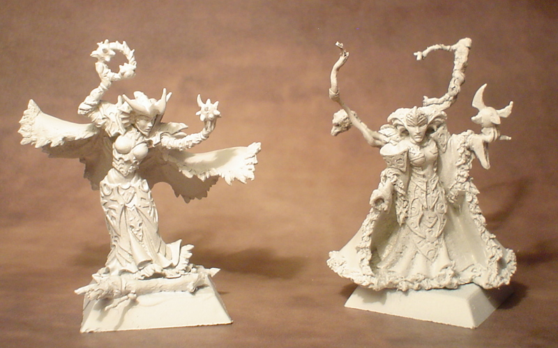

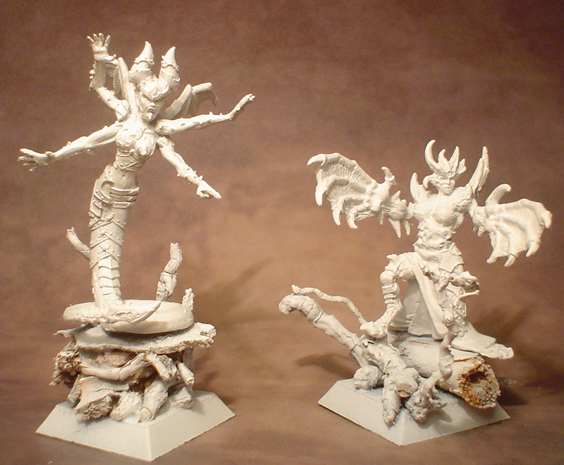

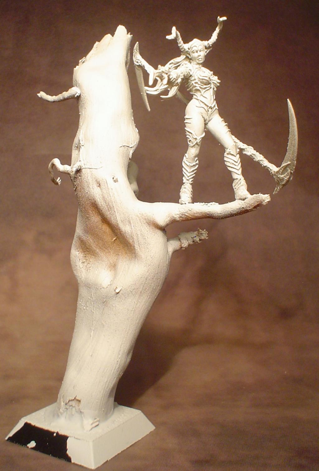

Shîvenos
Absylonia.
Succubus.

As the only released Akkyshan is from Cadwallon, here are some more ideas for undercover agents in the free city, a mother and her daughter. These are from Malifaux.
Widow Weaver.
Mysterious Effigy.
Another Vârmishi character
An Atrâsh character and someone not quote figured out yet.
Saeryn & Rhyas.
Strider Deathstalker would make a fine archer character.
Absylonia (2nd Incarnation, so to speak) as a Shîvenos character.
Bayal as an Akari character
Spawning vessel acolytes as special troups, maybe another warrior monk.

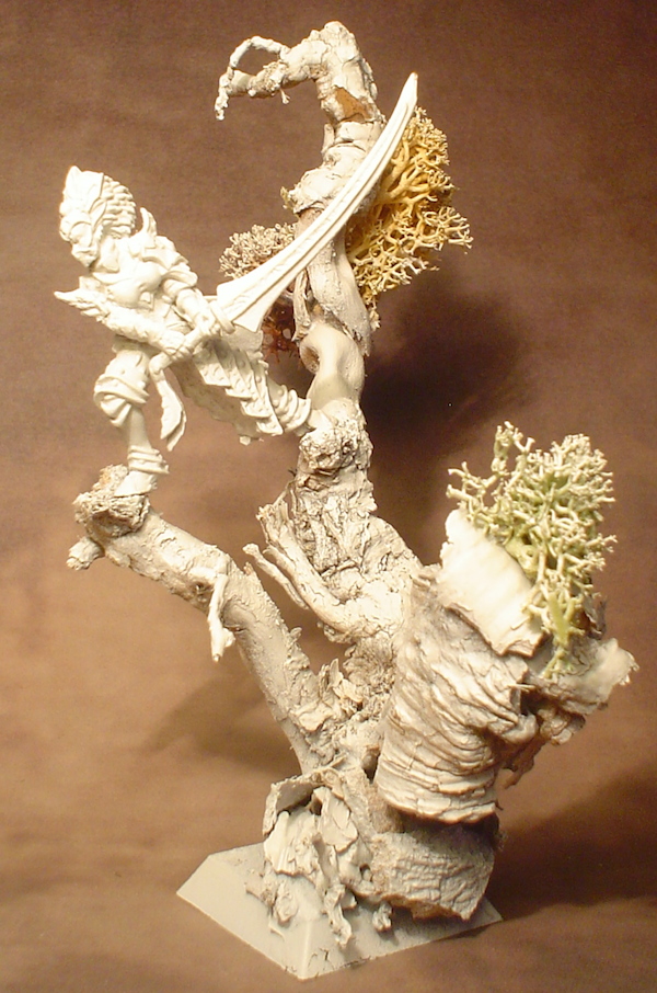

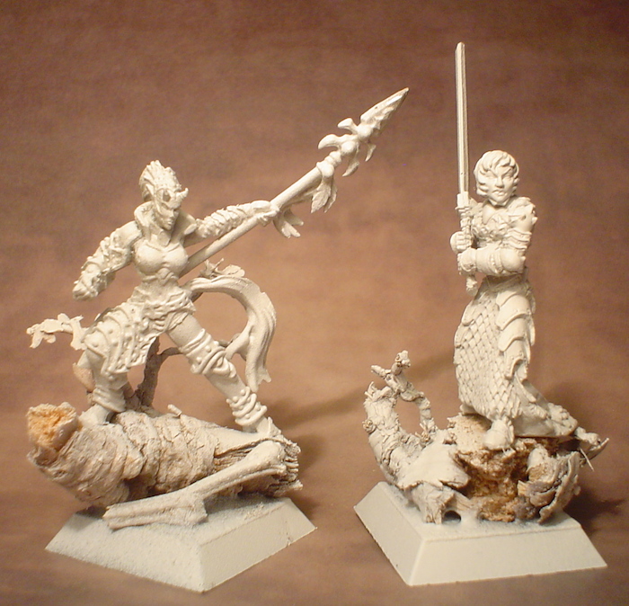

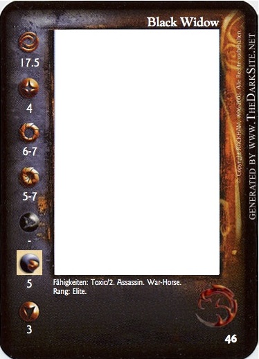

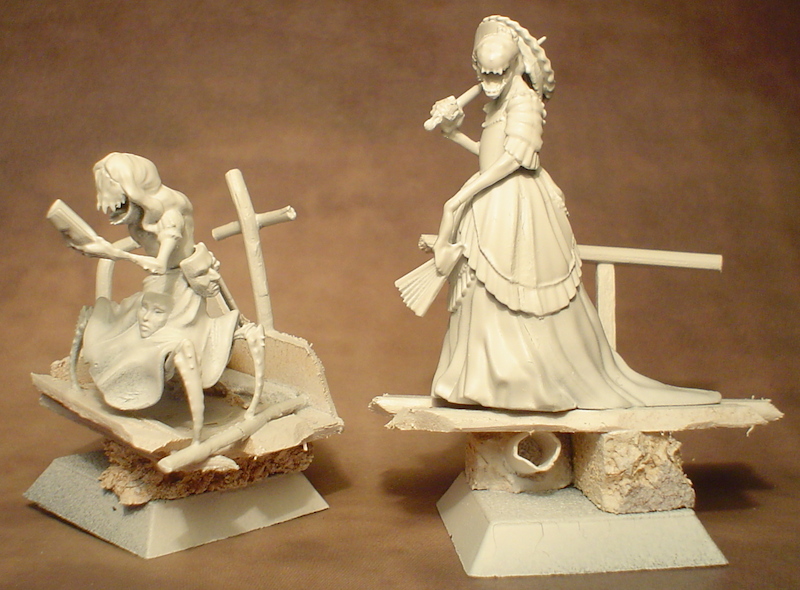

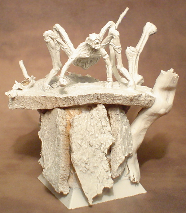

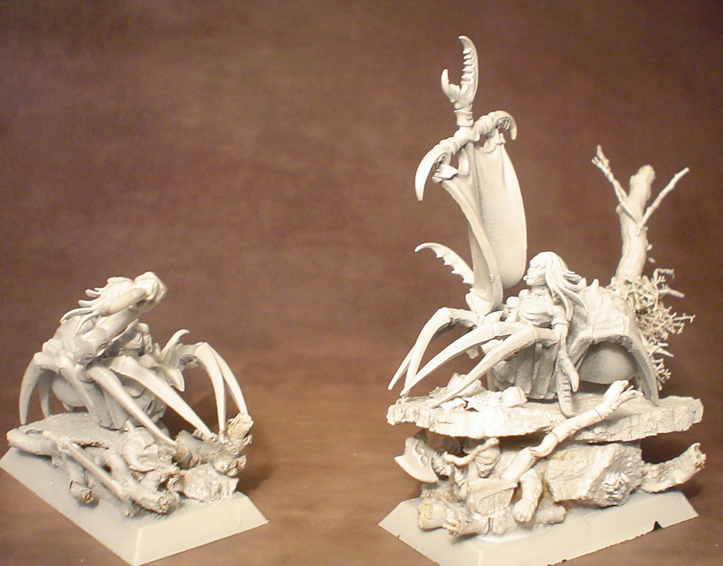

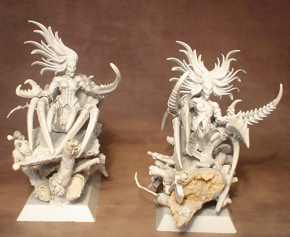

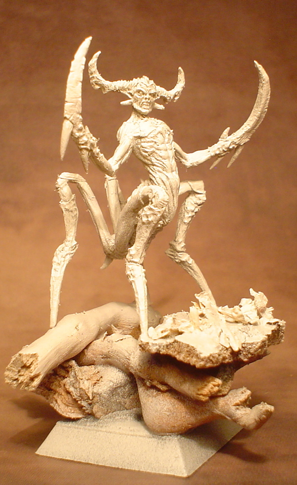

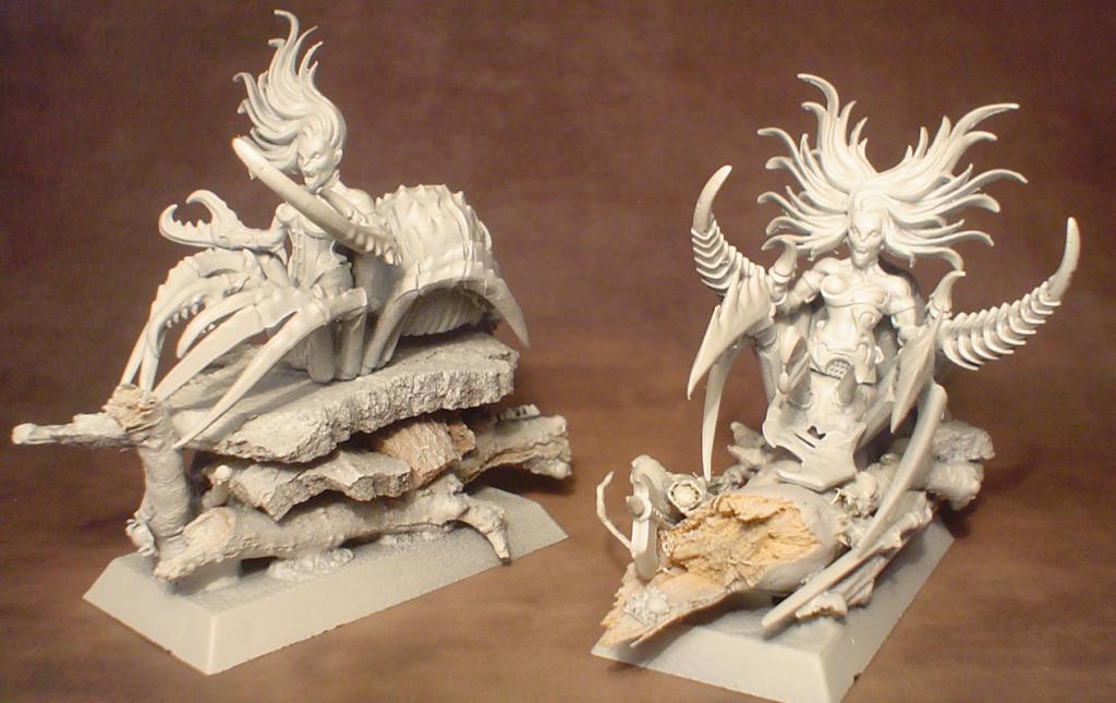

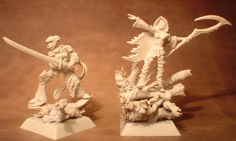

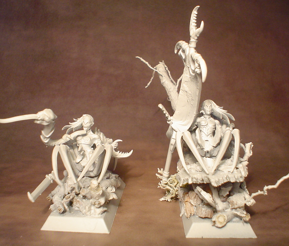

I came up with some conversions for the Black Widows. In the fluff it is said, that these Akkyshan are blessed by their goddess and have a body half elf, half spider. In the Newsletter No. 12 is a wonderful picture (page 50 in the pdf). The driders you can find for example at Reaper are not really appealing to me, so I converted some myself. I used Goblins Spiders for the body and Daemonettes for the upper body.
Everywhere in the base are some other bits from Confrontation miniatures (hey, at least some metal on this Wink) and little spiders as well. I want to heavily cover them in spiderwebs, so it looks like a cocoon.
The lady on the right will be a character and a priest.
The warstaff.
Over the next few days, I will come up with some stats for these and for some characters, also with the first revised cards. And I'm keen about your reactions.
Messages: 3 845
MessagePosté le: Mer 30 Déc - 16:35 (2015)    Sujet du message: [CREA-AKK] Akkyshan Elves Répondre en citant
Dridders are not easy to be converted, the jonction between the human body and the spider body is always a very complicated point!
But your conversions are nice, a little too much static but that's the big problem with dridders!
I'm curious to see them painted and mixed with the rest of your army... Wink

I finally made the first characters and build some cards with the pictures in it. Have fun with it!
So far you know them already, here come the characters.

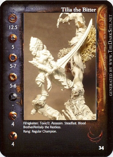

Tilia the Bitter (Eriophyes tiliae is a mite that forms the lime nail gall or bugle gall.)
She suffers under the same cruel fate as Ambaly and stayed in the ranks of Vârmishi since ages. But contrare to Ambaly, she will not settle with this situation and tries very hard to finally step up in rank. Her endless futile attemps made her bitter and disillusioned her.
Artifact: Theshenar
Cost: 10 AP
reserved to Tilia
After her first attemps to climb up ranks, she got so upset, that she killed her instructor in cold blood. But since then, the spirit of Theshenar accompanies Tilia in the sword used in this murder. Tilia can use the power of her instructor.
This artifact gives Brutish Charge and Masterstrike/3 to Tilia.

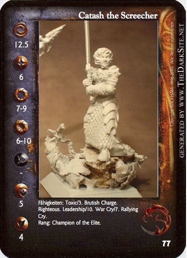

Catâsh the Screecher (Delta Atracotoxin is the venom of the Sidney Funnel Web Spider Atrax robustus who already named this unit)
If there is one thing to say about Câtash, it is her voice. She can be heard everywhere, at least it seems so to her inferiors. With a loud, harsh voice she bellows orders and forms the army to the will of her masters.
Artifact: Horn of Neriene (Neriene radiata is the filmy dome spider)
Cost: 13 AP
reserved to Catâsh
Neriene was the name of a huge, old spider, who fought many battles alongside the Atrâsh warrior, and when she eventually died, Catâsh took the horn and used it to increase her voice even more.
The use of this artifact has to be announced when Catâsh is activated. It gives to max. 3 fighters in Catâsh's area of Leadership the ability Possessed for one round. Furthermore, those affected fighters are activated at the same time as Catâsh. They can not profit from the extra order ability of the Atrâsh in this round.

Some new characters and finally a card with picture from the Warrior-Mage.
Firia the Border Guard (Dolomedes fimbriatus is a hunting spider)
She roamed the borders of Ashinan since she was a little girl, and the secret ways of the forest are not strange to her. She spots every intruder and deals with them mostly on her own. Those who escaped her can't escape the Web of Ashinan and will eventually end as prey for the inner guards. Since she literally one with the forest, she developed a special toxic to blend in her environment.
Artifact: Camouflage Toxin
Cost: 10 (?? not sure about this yet)
reserved to Filia
When Firia is spotted and no longer hidden with her Scout ability, she can use this Toxin. When she is not in contact with an enemy fighter at the end of her activation, she can sacrifice one toxic dice. Then she is hidden again with the Scout ability.

After some discussions with other players, I changed the stats and a lot of stuff was added as well.
Basically, the Spider Elves should have a high INI, ATT and STR, average DEF and low RES to resemble the spiders a bit more, as they are quick and strong, but easy to crush. Then the importance of the lower ranks and their sacrifice is even more stressed.
And, as I heard from ghokm, his miniatures based on my work will be previewed in the next newsletter? That'll be cool! Okay
So, here are the redone and new cards with the proxys I want to use.
Vârmishi (the name derrivates from "vermin“)
Abilities: Toxic/0. Devotion/3 OR Martyr/3.
Archer: Bow/STR 4. Range 20-40-60.
Abilities: Toxic/0. Devotion/3 OR Martyr/3. Instinctive Firing.
Abilities: Toxic/1. Fanaticism. Resolution/2.

Fherân (derivated from "feral“)
Abilities: Toxic/2. Consciousness. Ferocious.
Abilities: Toxic/3. Brutish Charge. Righteous.
Special Ability: An Atrâsh can give a command to one inferior in 20 cm around him. For this command he has to reduce his MOV for this round for 5 cm. When he has moved already, he can not use this ability. A Vârmishi or Akari can move again his MOV on the card. With this movement he can engage (not charge) an enemy. If he has to resolve from hand-to-hand combat, he gets Disengagement/5 for this.
Abilities: Toxic/2. Leap. Thaumaturgy. Novice of Lilith/15. Warrior-Monk.
Additional Limb.
Special ability: The Shîvenos are able to perform a glide. To use this, they have to perform a leap during their movement phase and still have at least 5 cm left. Instead of landing after the leap, they can glide in the following round on altitude 1, but they must land at the end of their movement phase with at least 5 cm left. During the glide, the Shîvenos can perform miracles and get TF. Other flying enemies can attack the Shîvenos on altitude 1, but the Shîvenos itself can not attack other flying enemies. But she can engage an enemy on altitude 0 during the landing. This is not the dive attack.
Abilities: Toxic/2. Leap. Vivacity. Initiate of Darkness/Black Magic. Warrior-Mage.
Black Widow
These creatures belong to the most horrible creatures that roam through the woods of Ashînan. No intruder is safe from them, as they are always hunting prey and strangers. Daikinee mothers only whisper about them to their children, but reality is much worse than any tale.
Abilities: Toxic/3. Assassin. Born Killer. Vivacity.
Parâsh (Sparassidae are Giant Hunting Spiders, the largest spiders in the world)
In theory, there should be no mistake during the creation oft he Black Widows, as both Black Magic and the blessing of Lilith guides the ceremnoy. But in some rare cases, a male specimen is formed. Andi t is even rarer, that those creatures are not immediately killed and turned to food, but survive with a lot of luck and skill. Those rare and scary creatures grow to enormous sizes and are calles Parâsh. Although they are abominations in the eye oft he Akkyshan, they would not hesitate to use them for their needs.
Abilities: Toxic/4. Enormous. Born Killer. Brutish Cahrge. Hard-boiled.
Note: This thing is really huge, that’s a large creature base like the ones from the Worg or Ophidians.
Barghest
The Spider Elves fighting dogs are a commanders first choice to hit a target quick and hard. The first Barghest came from an Akkyshan raid on Cadwallon. They stole some puppies from an Upper City nobleman, usually used to protect the estates. But with the blessings of Lilith, usual watchdogs became savage beasts.
Abilities:Toxic/1. War-fury. Brutish Charge.
Pandin (Pandinus ist he species of Giant Scorpions)
Inspired from the Daikinee’s strong bond with beetles for battle, the Akkyshan used their allies, the Alchemists of Dirz, and their knowledge to create these creatures from a scorpion and a spider. The Dirz used those gene sequenzes for their own experiments, and who knows what they have done in the meantime in their dark laboratories.
The strength and lust for fighting always troubles and injures the Fhêran, but they won’t go without the benefits of the Pandin.
Abilities: Toxic/4. Born Killer. Counterattack.

Giant Spider
The silent but yet powerful movements oft he Giant Spider often frightenes the enemy. How could something so big can move so quiet? This horror even increases, when the spider spits her sticky-toxic net to catch her prey.
Net/STR 5. Range 15-20-25.
Abilities: Toxic/4. Assassin. Leap. Born Killer. Ambidextrous.
Hunting Spider
The little sister oft he Giant Spider serves as scout and weapon behind the enemy lines. They are capable of enormous damage and because of her versality, she is always the first choice of a Fhêran.
Abilities: Toxic/2. Scout. Brutish Charge. Ruthless.

Tilia the Bitter
Abilities: Toxic/2. Assassin. Steadfast. Bloodbrother/Ambaly the Restless.
Artifact: Theshenar
Cost: 10 AP
reserved to Tilia
Abilities: Toxic/3. Brutish charge. Righteous. Leadership/10. War-cry/7. Rallying cry.
Cost: 13 AP
reserved to Catâsh
Javelin/STR 6. Range 15-25-35.
Abilities: Toxic/2. Scout. Harassment. Wild/10.
reserved to Filia

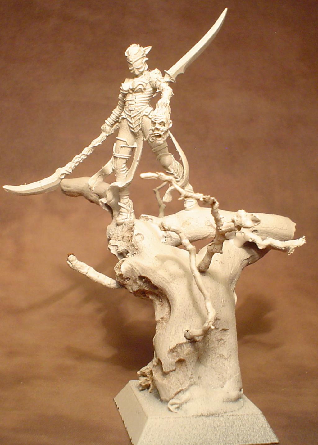

Nysha the Claw
(Dionycha is a group of spiders with the Tarsal claws that already named the Warrior-mages)
To survive the harsh conditions in the army of the spider, one has to be tough. Nysha is one of them. Although she is young, she seems to be very promising and will have a great career within the witches of the web. For now, she gives orders to the inferior Tarsals, but she is already looking up to the next rank and the new mysteries within there.
Abilities: Toxic/2. Leap. Survival Instinct. Fierce. Initiate of Darkness/Black Magic.

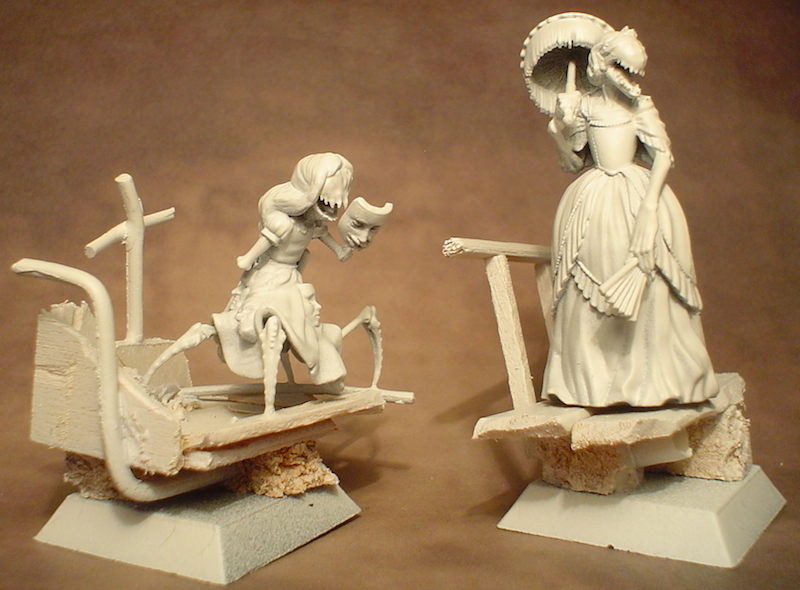

Pecosha the Elegant
(Alopecosa is a genus from the Wolfspiders that are known for care of the brood)
She is a secret agent in Cadwallon, searching for secrets and any advantage for the Akkyshan that might come in handy. Her official face is that of an elegant, rich and eccentric lady, but very few know about the darkness that lingers behind the fine manners and clothes. Together with her child Amaur she waits and fulfill the orders from Ashinan.
Abilities: Toxic/3. Assassin. Hard-boiled. Infiltration/10. Alliance/Akkyshan.
Amaur the Mask-like
(The children of the spider Amaurobius fenestralis eat their mother)
Together with her mother she serves the Akkyshan in Cadwallon, but the young whirlwind wants more, since she experienced the life in Cadwallon. She wants to be free from the orders of her mother and the superiors from far away, she wants to revel in her bloodlust and atrocities, but not in the command of some persons she has never seen at all. Maybe some day, she will be free. Maybe some day, she can be free, whispers the Ursurers to her.
Abilities: Toxic/2. Scout. Assassin. Fast Reflexes. Alliance/Akkyshan.
Special ability
I'm not quite sure about it, but I thought about something like this: When mother and daughter are fielded together, they can get a special ability for extra AP. This ability should represent their undercover assassin-life in Cadwallon. Before the deployment, the player draws a card from his opponent's deck, but no characters, just troups. Pecosha and Amaur are not fielded regularly, but put aside the field. From the first round on, the player can announce that they join the battle when the chosen card from his enemy is activated. The model is removed from the game with a deadly wound (if the card represents more than one fighter, the Cadwallon player has to chose one miniature) and Pecosha and Amaur are put in this place (or at least Amaur and Pecosha in max. 10 cm distance). They assassinated the fighter before the battle and dressed up like the fighter to bring chaos to the enemy.
Of course, Infiltration and Scout are not used with this ability.
Example: Before the deployment, the Cadwallon player draws a card from his opponent. This card are three Griffin Conscripts. Pecosha and Amaur are not deployed yet. In round three, the Cadwallon player decides that Pecosha and Amaur finally reveal themselves. One of the Conscripts is removed (Killed Outright), and Amaur fills his place. Since she is surrounded by other Cadwallon fighters, her mother can't be placed right beside her, but in a distance of 10 cm around her.
How much should this special "artifact/ability" cost?

Abilities: Toxic/2. War fury. Brutish charge.
Fleshhunter
Circle of Cibûsh
These special trained assassins do not mean to kill their prey, but to put them out of action, so that they can be food fort he new brood. They support the Circle and tenderize the prey during the battle.
Abilities: Toxic/2. Implacable/1. Feint.
Special Ablity: When a Fleshhunter inflicts a „Stunned“ on the Wound Table, the victim loses one fighting dice at the same moment.
